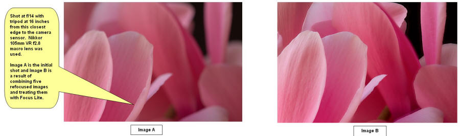

The most inventive machine on the planet is the human mind. It never stops being curious and never stops coming up with creative solutions to problems. So it should not come as a surprise that technology, in the form of a software product called "Helicon Focus Lite" (www.heliconsoft.com), has addressed and mainly solved the shallow depth of field problem when using a macro/micro lens at small or moderate reproduction ratios (see below). Here the terms micro or macro mean the same type of lens, those used in close-up photography. To give you some idea just how marvelous this piece of software is, lets look at some flower petals which are of low to moderate contrast and very difficult, at least for me, to even manually focus sharply.
If Image B does not impress you, think about this. At a focal distance of 16 inches, the depth of field of the Nikkor 105mm is about 0.1875 (3/16) inches (~5mm). From front to back the petals span 1.5 inches and thats why just about everything in Image A, except the outer edge of one petal, is out of focus whereas most of Image B is in focus; look at the edges and you will see what I mean. The results are not 100% perfect, but I never look a gift horse in the mouth. OK, I hope you are excited so lets get into some technical jargon so you can understand a little about the limitations of sharpness for a macro/micro lens.

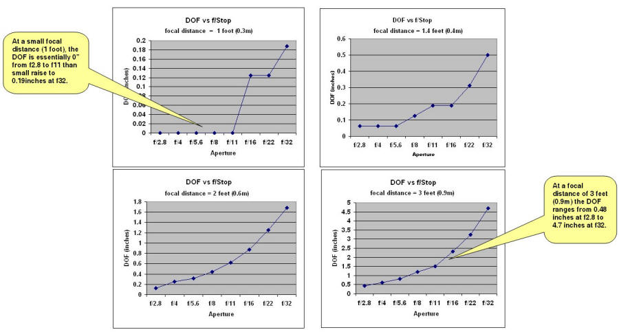

The depth of field (DOF) depends on the aperture setting and focusing distance. With zoom lenses it is still essentially the case but changes in the focal length give different magnifications which make it appear that the depth of field has changed - it stays virtually constant as you zoom in and out. Now a macro-lens has very small depth of field at focal distances of around 3 feet (~1m) or less. At focal distances of 1 foot or less (<= 0.3m), the depth of field is essentially in fractions of an inch (0-5 mm) or close to zero from f/4 to f/22.. All this translates into the simple fact that when photographing close-up of a non-planer object (something other than a flat surface, say a flower or insect), those portions of the image closer or further away from the point where the lens focused will be out of focus. I like the creative possibilities of out-of-focus images but I also like the idea of subject matter being sharp and crisp when I want it to be sharp and crisp. Yes, maybe I am spoiled but now everyone can be spoiled using Focus Lite. Well, lets turn to the depth of field for 105 Nikkor to see what we were up against. Note I used the past tense here.
Depth of Field Charts for 105 Micro Nikkor;
To demonstrate this easy-to-use software, we will employ a Nikkor 105mm f/2.8 Macro lens. Lets get a view of just how limited the depth of field can be then apply the Focus Lite software.  These charts are from actual data from that lens:

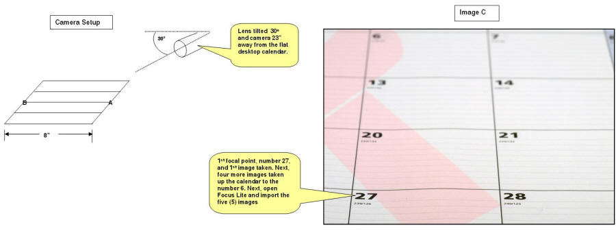

Camera and Calendar Setup
1. Five shots were taken with camera setup shown below.
2. Point A is the number 27 on the calendar and point B is the number 6 barely legible in the first shot, Image C.
3. Shots were taken with the lens focused on the numbers 20, 13 and 6 were focal points and mid-way between 13 and 6.

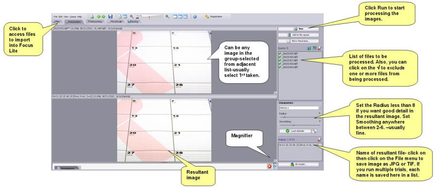

I wont go into all the details of how Focus Lite works but will explain the simple steps to get good results when using this very handy program.

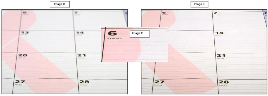

Ok, lets see how we actually did. The span actually seen by the lens-sensor combination is not 8 inches from the number 27 to number 6, but 6.9 inches due to the 30 degree tilt of camera lens. Nonetheless we are talking almost 7 inches as a needed depth of field to get sharpness throughout. According to Nikkors DOF tables for 105mm Micro-lens, the depth of field for our camera-object settings is approximately 0.75 inches and here, we are talking roughly seven (7) inches for the depth of field to cover the calendar span. Well, did we? One only has to look at Image E. I say Focus Lite did an admirable job, but the focusing wasnt too bad either! To really appreciate how well this Focus Lite does, just look at Image F. It is an enlarged area around the number 6 of Image E. You can actually see the separation of dots in the gray dotted-line - nothing is blurred out. This is credit to the lens and Focus Lite.
