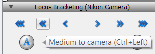

At least with some of my consumer lenses – particularly the 18-55mm kit lens – on my consumer (camera) body – the repeatability of the focus bracketing is imperfect.  When I “exactly” set the A and B bracketing stops, I often miss out on some parts of my subject, towards the camera and towards infinity.
Solution: pick the perfect nearest point, and then click a few “Medium to Camera” buttons before “Saving the Nearest Point” when you click “A”:
Pick your ideal farthest point, and then click a few “Medium to Infinity” buttons before “Saving the Farthest Point” when you click “B”:
You may get some totally-unfocussed frames or some unwanted in-focus areas – but you don’t have to use them in your processing stack.  My kit lens makes big focus changes with small movements, while my other lenses make much smaller changes. So know your lens and click accordingly.

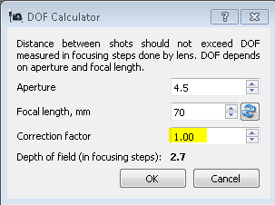

Helicon Remote does a good job of estimating DOF based on your aperture and distance from subject, then splitting up your A and B stop points to decide how many shots to take.  But it isn’t perfect.  Up at “flower-close” range with f/8 or smaller, I find it under-estimates.  So I un-select Auto and add a few Shots – typically about 20% more.  But this varies by lens, so on your lens-data chart, jot down what works for you.
Alternately, Helicon Remote will manage extra (or fewer) Shots for you.  Just click on “DOF” from the main screen, and then change the Correction factor as below.

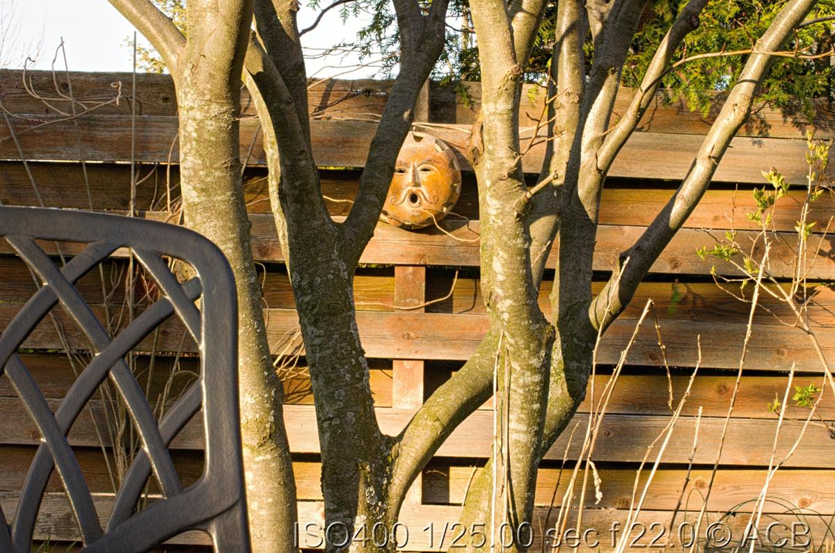

Outdoors, technically-interesting depth of field, 23 shots (try doing that by hand) stacked, focus from 6 feet to about 35 feet – all at f/22 for a soft, but of course in-focus, look.  The image is good with just “Method C” defaults and no manual touchup or post-processing at all.  Imagine what you will do with more care:

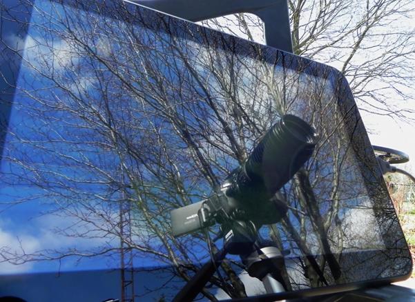

Here is the setup shot – a great way to spend a few minutes on a beautiful day.  Notice that I did not drag my laptop outside – everything was done from a handy Android 3.2 tablet propped up on a lawn chair. In this case, a Toshiba AT100 – it has a built-in “USB Host” port, needed for Helicon Remote Android, and built-in full-size HDMI, convenient for showing your stuff on a big screen.  The tablet wasn’t easy to read in full sunlight – notice the beautiful reflection – but it was better than my laptop and useable enough.  Use your camera’s LCD loupe as required.  My next attempt will have the tablet mounted to the tripod – plenty of commercial mounts are available – and that setup is portable onto a trail.  Just keep the screen from being a mirror to a bright surface, as I have used it in this shot, and all is well.
