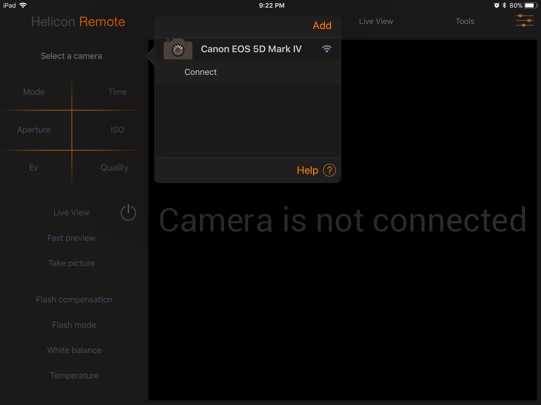

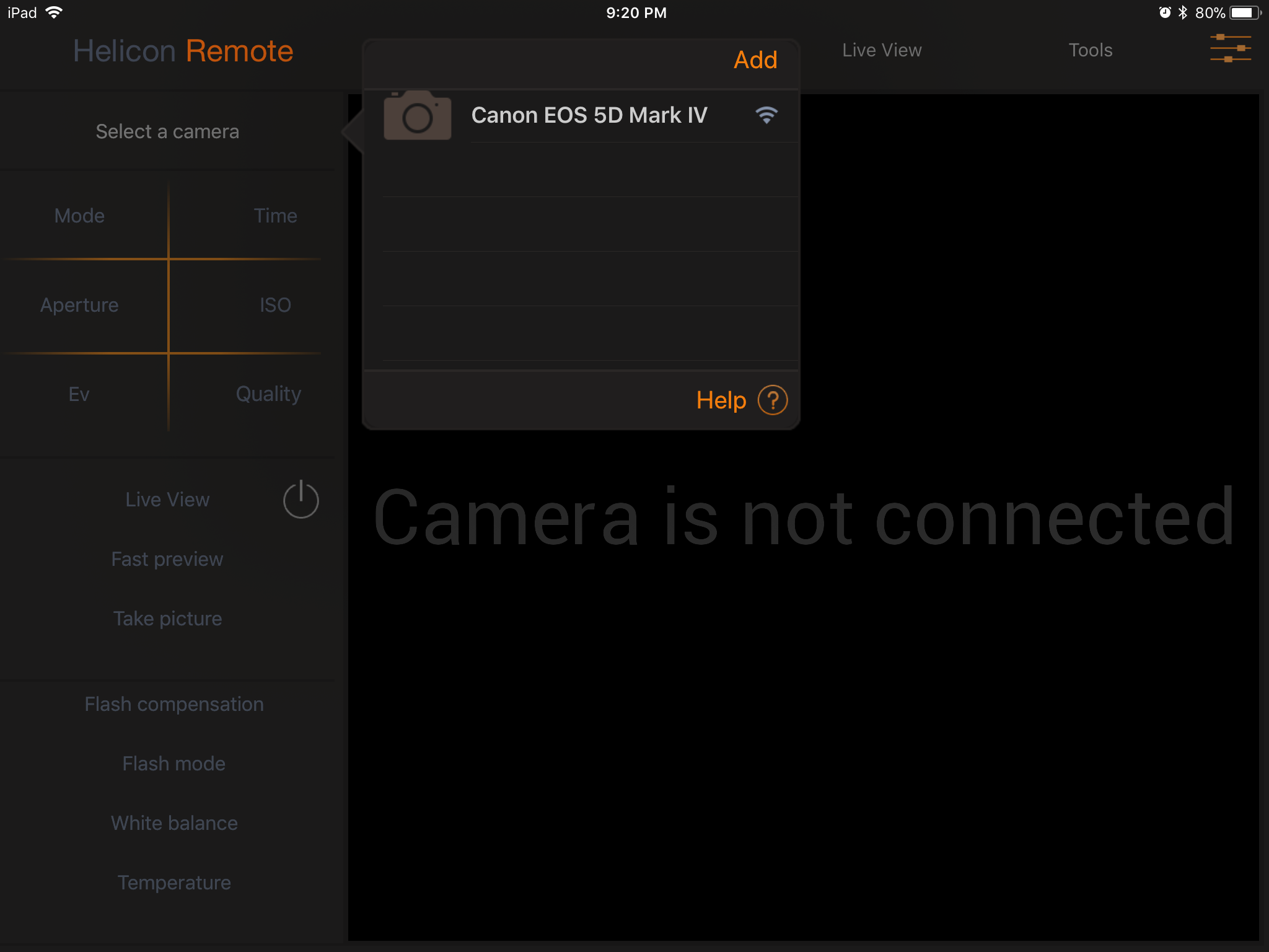

I am struggling with this myself. I have a 5D4 and I’m following the instructions for the 6D, which are on the app. I am on an ipad. The instructions show to connect to the ‘helicon’ network, while going though the EOS utility section of the wireless settings. Does that mean that Helicon creates its own network? Because i’m Not seeing a Helicon network. Or do I choose my home wifi network? Please help.

Unread post by spiffypix » 30.01.2018 04:11
This is the message I’m getting
(403.08 KiB) Not downloaded yet
This is the message I’m getting. :(

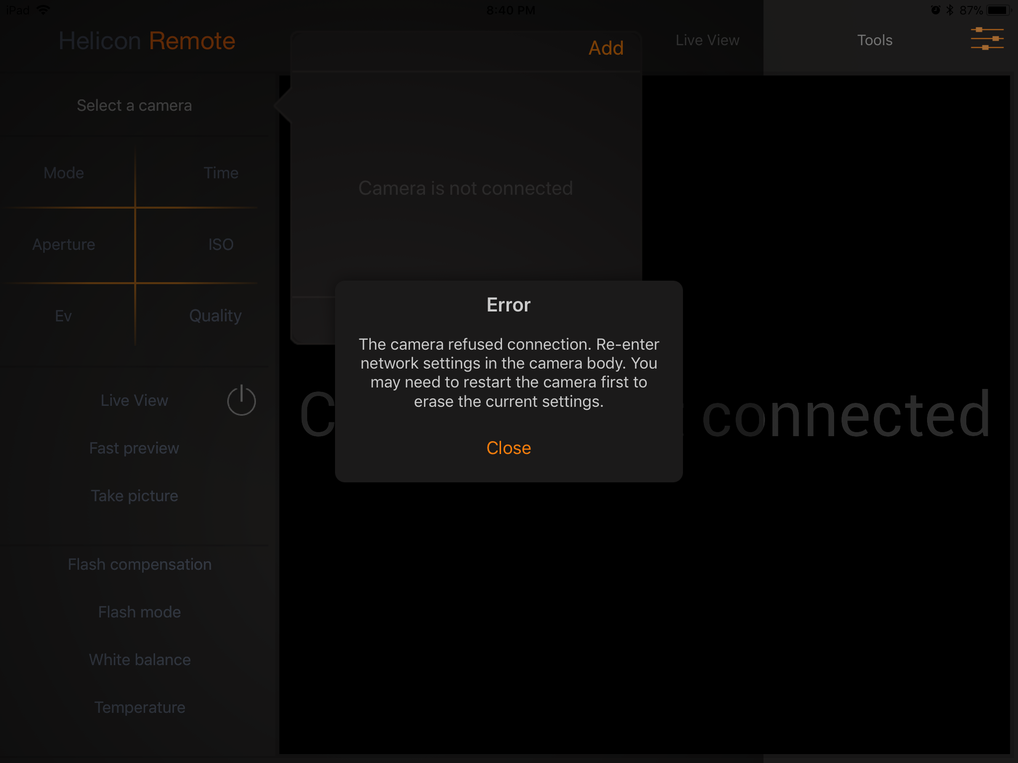

Unread post by spiffypix » 30.01.2018 04:25
(289.51 KiB) Not downloaded yet
(286.41 KiB) Not downloaded yet
It seems to be recognizing the camera, but then it tells me that the camera refused to connect.
Posts: 3562
Joined: 06.05.2009 14:05
Re: Wireless tethering with Canon 5D-MK4?
Unread post by Stas Yatsenko » 30.01.2018 15:03
The 6D manual is outdated, it doesn't show how to use the Smartphone mode which is what you need. You did everything correctly. This message means that you need to reset and re-enable Wi-Fi in the camera body. Make sure that the Canon app is not running or you will get the same error over and over when the Canon app "steals" the camera from Helicon Remote.

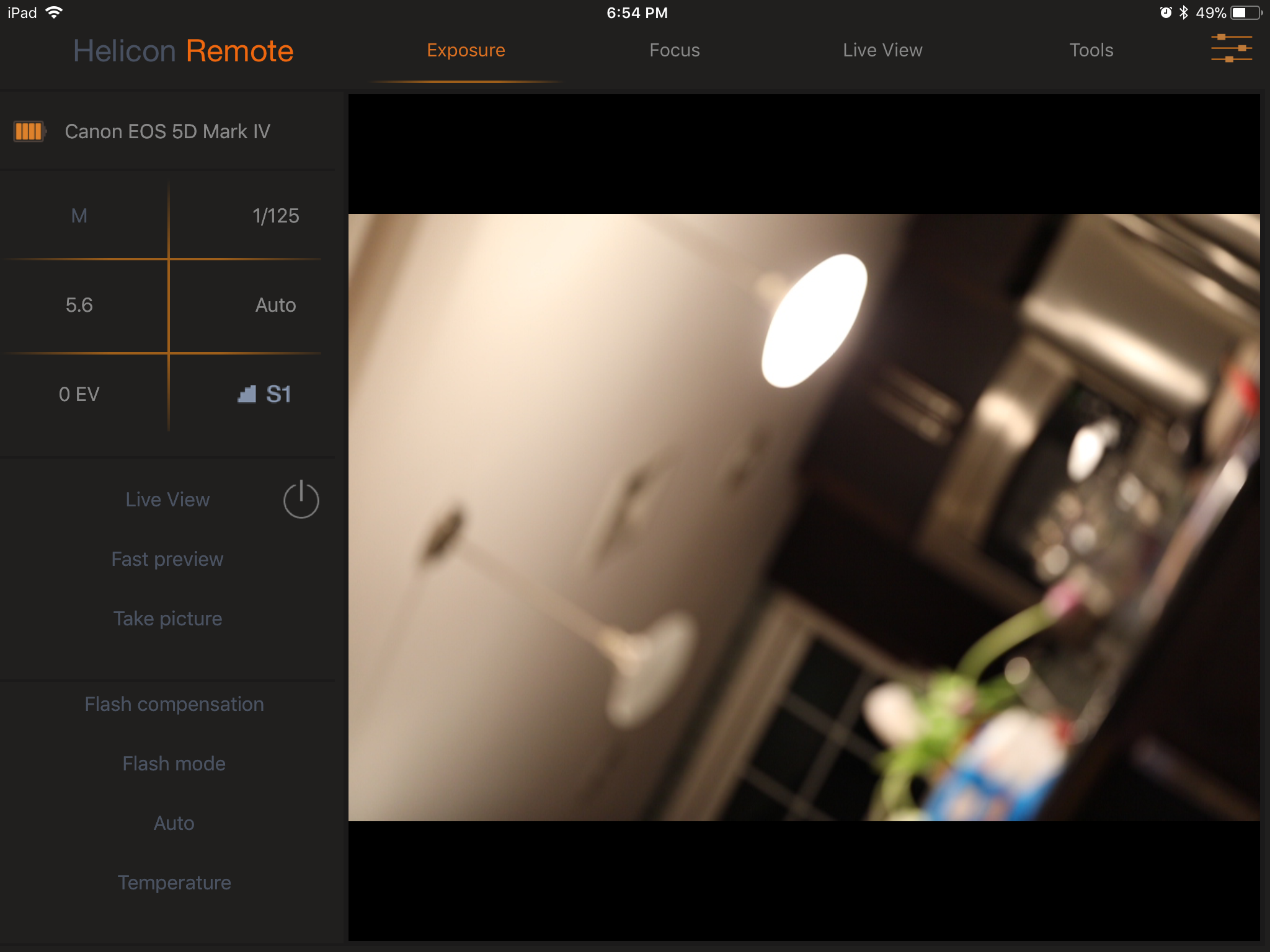

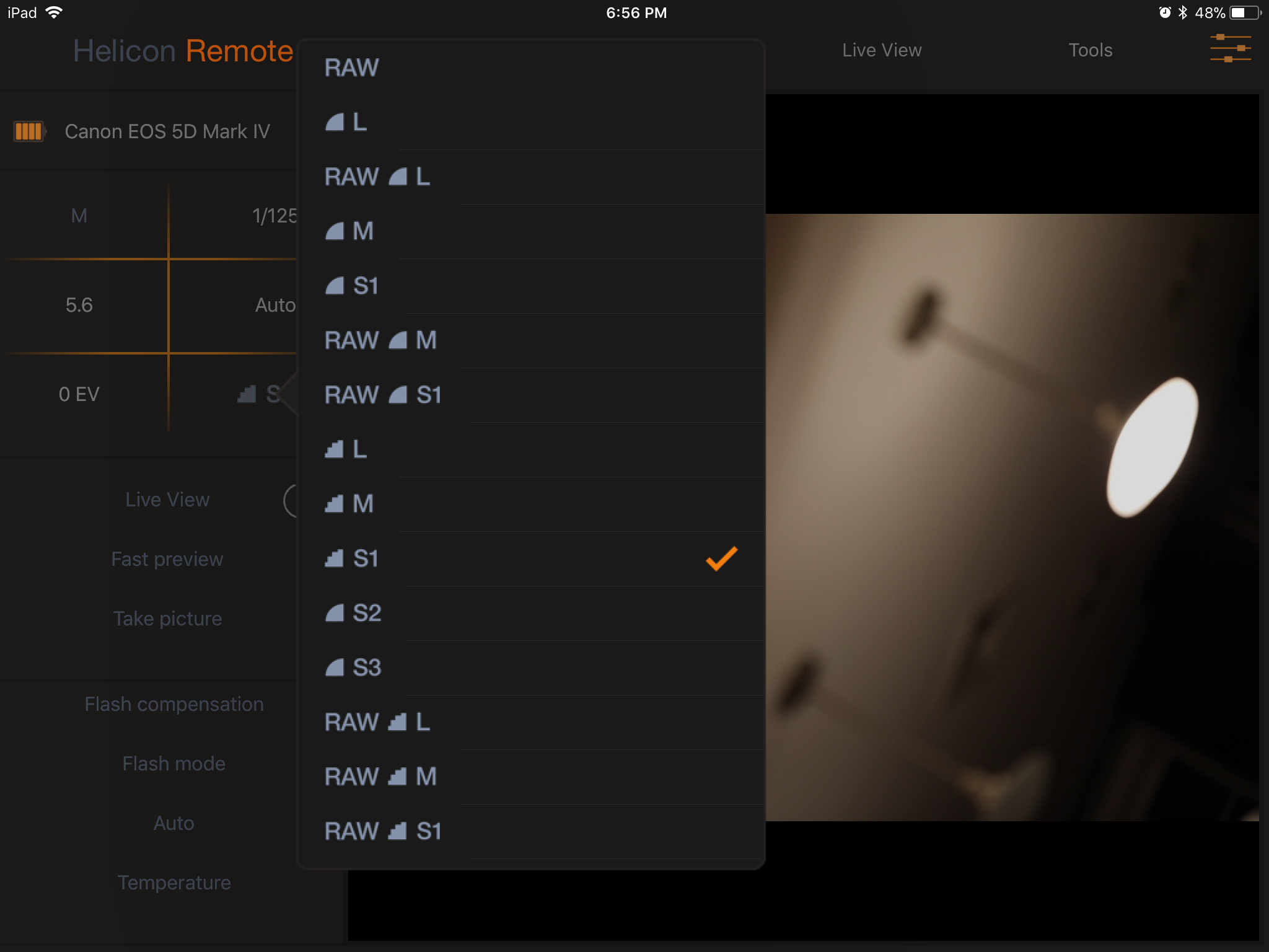

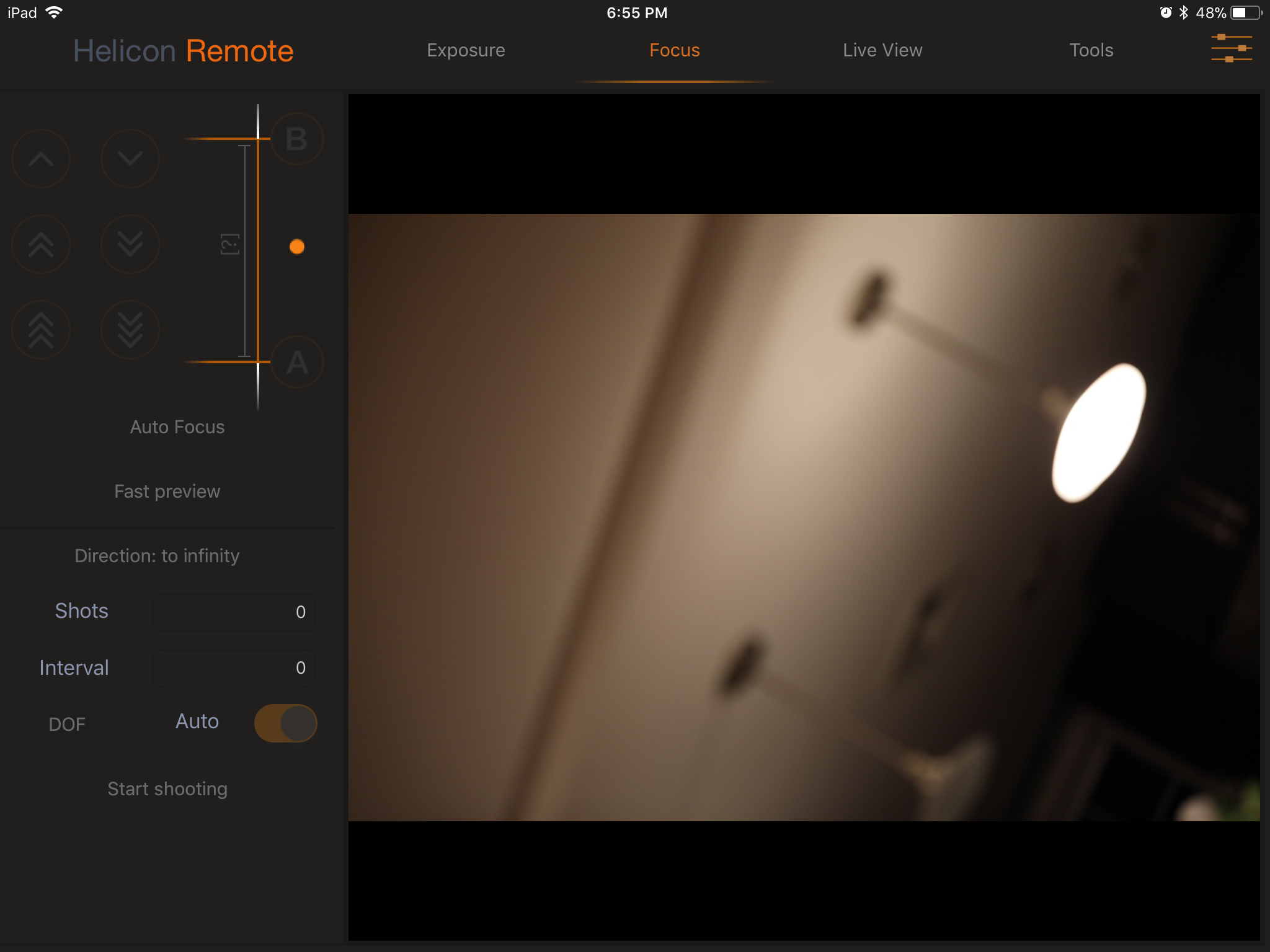

Ok, so I was able to connect, but the app appears to be unusable. Most of the options are either greyed out or I can access them but I am unable to change the settings, no matter how many times I click something. Help? I have reset my camera settings and uninstalled/reinstalled the app, to no avail. I’m shooting Canon 5D4 and 100mm f/2.8 L. I bought the license so I should have full access.

Sorry, I forgot that 5D Mk IV has this problem (or, more precisely, the app has this problem with 5D Mk IV). Yes, you need to use the computer / EOS Utility connection mode instead of Smartphone. Then choose "Quick connection", and the camera will host its own Wi-Fi network just as in Smartphone mode.

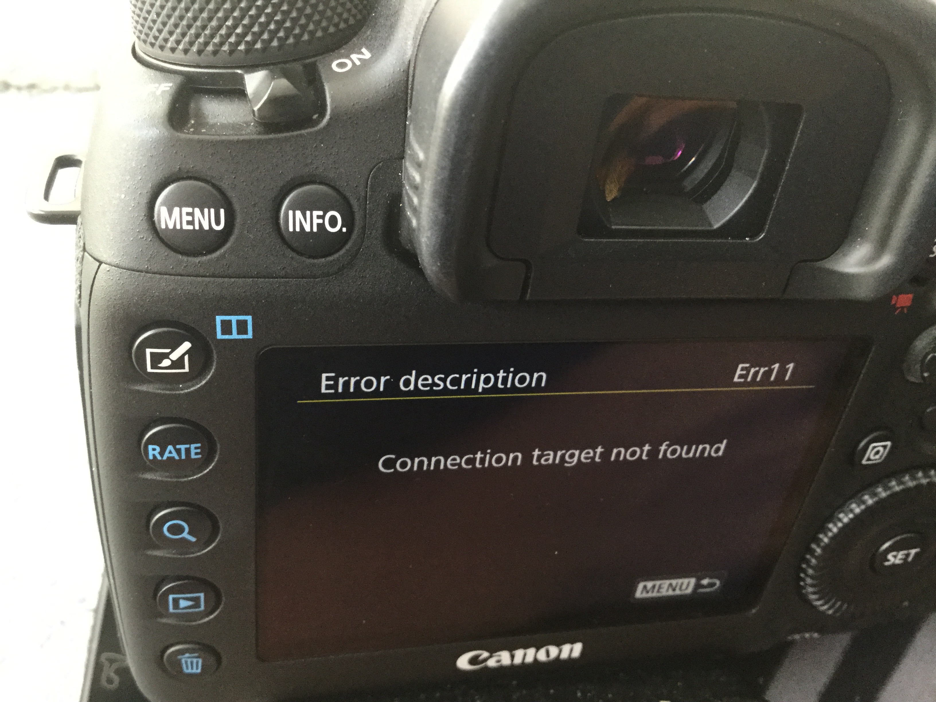

Unread post by spiffypix » 31.01.2018 21:59
Trying not to get frustrated. Still no luck. These are the messages i’m Getting after doing EOS utility/quick connection.
download/file.php?mode=view&id=827
download/file.php?mode=view&id=826
(403.16 KiB) Not downloaded yet
(1.51 MiB) Not downloaded yet
