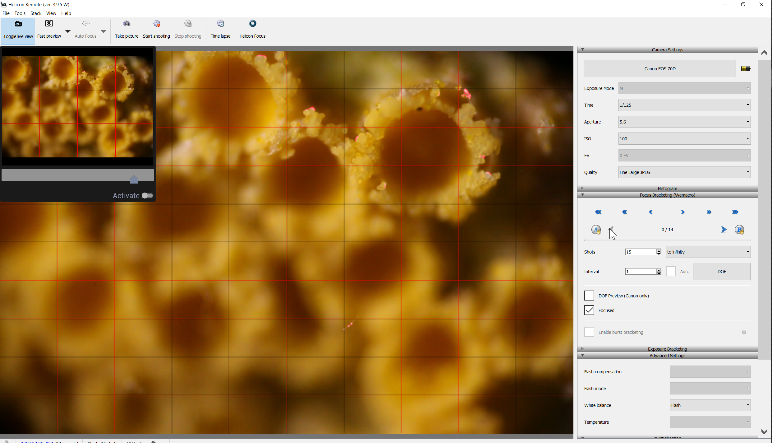

I am using Helicon Remote with a Canon 70D and WeMacro rail. In the upper left had corner of the view screen, there is a smaller view with a slider and an 'activate' switch. What is this for? How do I get rid of it? I don't see anything in the help about this.

It's the motion trigger. Menu -> Tools -> Events -> Motion.

It detects motion in the live view frame and draws a blue bar in real time representing the amount of motion. You can adjust the threshold value on the same bar, enable ("arm") this tool, and it will take a shot whenever the threshold is exceeded. You can also click any of the squares on the small live view image to include or exclude this square, defining a zone to detect motion in.
