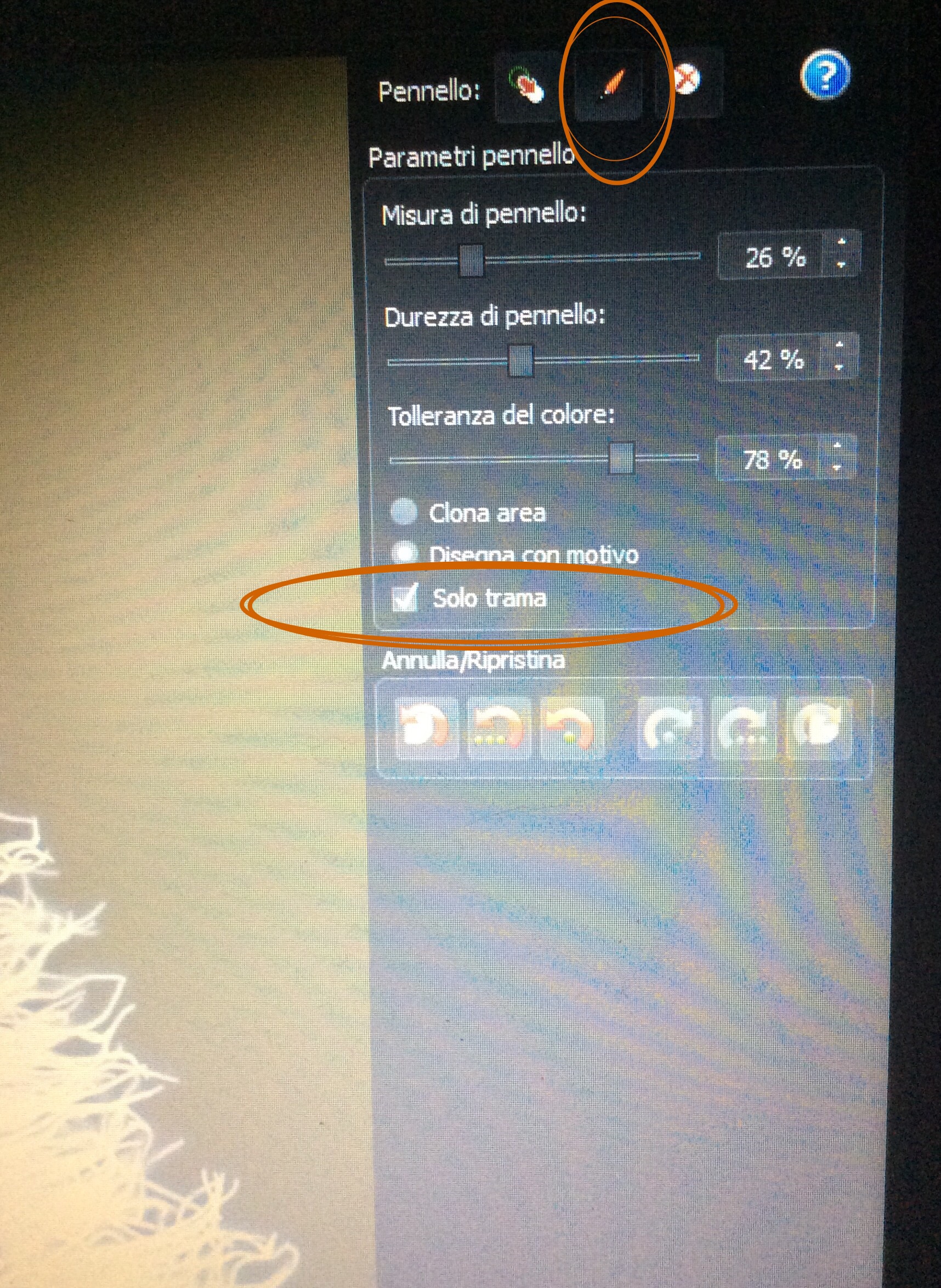

Anyway....I think I got it. I tried the brush you suggested to me and I think (for what I've been able to see) that enabling it for retouch from a source image could be very handy and probably....yep! it could resolve a lot of problems when using the pyramid stack as a source. I can't be completely sure, but, to me, seems to be what I was searching for.
If you can implement it would be great and, in any case, I'm sure it will be an handy instrument.
I've attached a terrible iPad photo-from-screen, (sorry for the Italian translation too) of the brush I think we are talking about (just to be sure)

Re: Some suggestions/requests
Yes, this is correct. We will add this option to Copy to source brush too.
