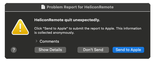

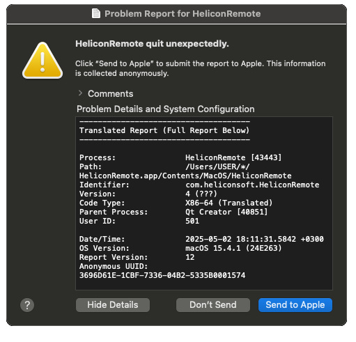

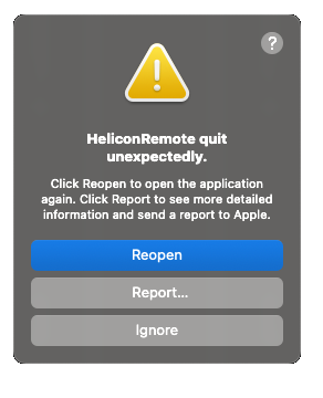

Q: Reporting a bug on Mac OS X in case of Helicon Remote crash
A: There should be a pop-up message stating that the program has closed unexpectedly.
Press the "Show Details" button and it will open up long text that you should copy to clipboard and send us.
You can paste the text into the "Comments" field of Helicon Remote bug report.
